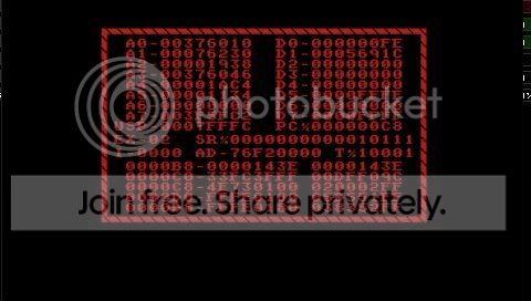

I'm getting a strange error from the Captive savestate :
It gets past the initial starting screens, but pops up that error just before the game starts.  Possibly a problem with the original rom, anyone else tried this savestate ?

Did you load the config first, then the state?

problem with the original rom? i dont remember Captive ever being released on Rom.
i've tried this out of course, and it worked ok for me. i will look into it. details about what pspuae version you are using and stuff would help thanks mate
edit: right, i very briefly had the same problem.
all i did was manually set kickstart 3.0, saved "captive.config" - reset the emu, and loaded it again.... then it worked fine.

Yes Horace is correct, there is a bug in the current release, which has now been fixed, in the new beta, where it wasnt saving the kickrom of the state, even though it was displaying the correct 1.

Yep that did the trick, cheers mate.
