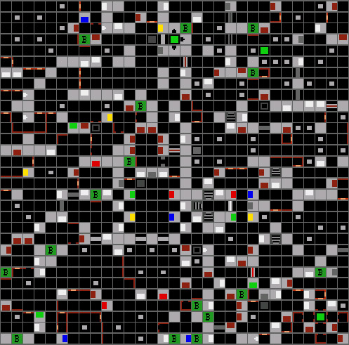

you appear to be missing a number of banners? (i.e. those which have automatic colouring)
http://www.ultimateamiga.com/HostedProjects/GamesCorner/TheCryptOfBloodwych/Maps/bw_keep_3.jpg
^^ look in th efirst main room after the recruitment area... there are various signs i have shown as 'white' which are generated at random (or rather, seeded "random"...)
here is my stone-wall code, which includes banners and gems etc.
like before, it probably uses some modulo functions where it would be better using bit-test functions... sorry about that!
to read about how switches are defined, see also here:
http://www.ultimateamiga.com/index.php/topic,8908.msg39953.html#msg39953
because the below code refers to a function which reads-in the relevant switch operation.

MadMunky
  • Karma: 2
  • Posts: 244
Re: Hacking: Open Contribution Thread
« Reply #76 on: May 24, 2012, 07:12:07 AM »
Good spot, missed that group off..
Also I'm looking into a new features which will let me support real time map editing in the Amiga/ST Versions when played on a emulator, also this will allow you to have a real time map which updates the player location :)
« Last Edit: May 24, 2012, 07:16:34 AM by MadMunky »

Real Time Player tracking is now working for Steem, I need to clean up the code and decide if I want to read all of the ST Memory so I can update the whole map (open/closed doors etc) then once this is all working nicely I'll add in a WinUAE option
MadMunky
  • Karma: 2
  • Posts: 244
« Reply #78 on: May 26, 2012, 01:13:22 PM »
I got real time tracking working with winaue also.
Horace any chance you want to share the source of your editor so I can try add all the same features as I can see any reason why I cant make my version support the same + Atari/PC support also
Had to add the option for winuae to rescan the memory as sometimes it will find the data in the HDD image not the live game :)
« Last Edit: May 27, 2012, 04:03:43 PM by MadMunky »

So live mapping is now working (read-only atm) but with the live data there is some different values have you seen these two before?
01 43
00 43
This is normally a Pillar/Bed but do you know what that 4 Means?
Also do you have any code for the different doors as I still need to fix this.
*UPDATE* Ah its cause there is items on the floor :)
« Last Edit: May 29, 2012, 02:38:15 PM by MadMunky »
« Reply #81 on: May 29, 2012, 05:22:55 PM »
i will upload the source for you when i get the chance :)
looking at map data as AB CD, in your example C = 4
bits are switched on/off in this value, to show what is 'occupying' the space. You will generally only see this when you look at 'live' data
this is entirely from memory, but i *think*....
bit 0 (usually C=1 ) is used for a door lock , bit 2 (C=4) you have just said is an object....   bit 3 (C=8) iirc is a person (monster or champion).... that leaves bit 1 (C=2) must be a spell in that location. e.g. a fireball that has been launched or similar.
obviously these can then also be combined if several of them are true!
what door code are you after? metal doors? i posted this already... :)
http://www.ultimateamiga.com/index.php/topic,8806.msg44182.html#msg44182
