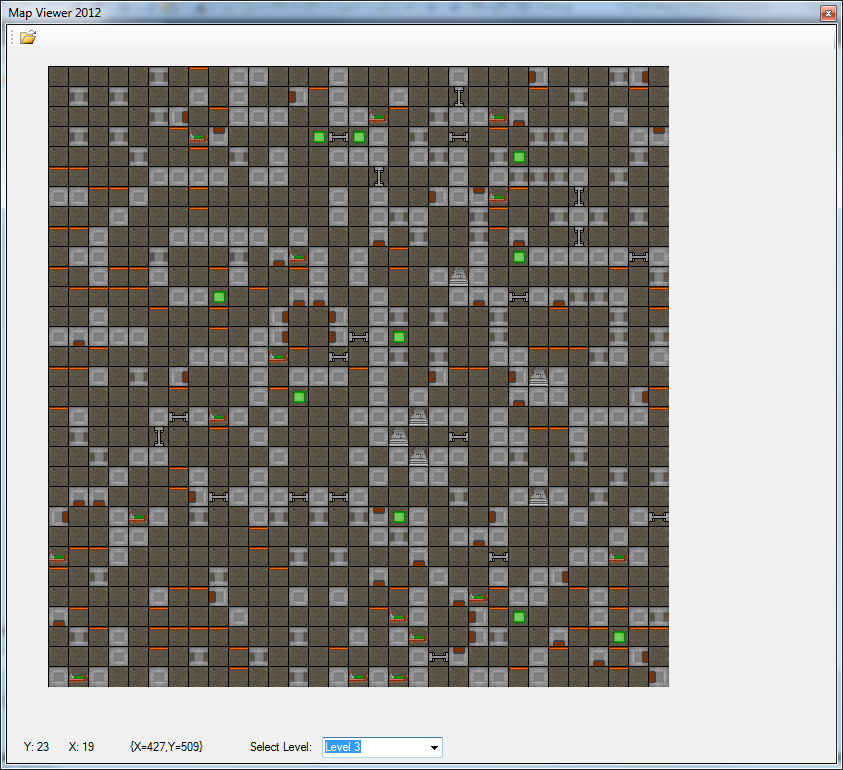

Hey There,
Since I completed the data disk, haven't had much time into refining this.
I need to refactor the code somewhat to make it a bit more understandable and modular. But then I would have no problem with posting code snippets to assist in demostrating logic.
Cheers

Hey, this site is back up :)
For reading binary, basically I read the file as a list of bytes and just accessed that list based off the known offsets.
For drawing the map, I'm just using some rudimentary system.drawing logic, not very efficient but does the trick. ;)
Unfortunately my time is incredibly limited at present, so may not be able to do much further work until near the end of year :(

Well I've finally started work on my own stuff as I have never programmed or done 3D stuff progress is slow but what im doing is a Map Editor/Viewer which supported Bloodwych Files see below
I cant work out how the orientation of the Wooden Walls/Doors is done yet but will look into that as its only a start (if anyone can help me out with this they are more than welcome). I've also started to write a Bloodwych remake engine the plan is to be able to support the Bloodwych map files and also my own type based on these I only started this a couple of days ago but progress is going alright im focusing on getting the engine to look right and have multiplayer support (local and network) so when your playing via the network its still split screen updating the window below like Bloodwych was when you played together on the same machine.

MadMunky
  • Karma: 2
  • Posts: 244
Re: Hacking: Open Contribution Thread
« Reply #74 on: May 23, 2012, 07:11:18 PM »
Wood Walls and Banners/Switches now supported just need Gem Slots and to sort out the Doors now..
