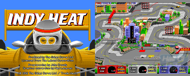

Indy Heat

I am currently re-colouring some half-size versions of the cards from the unreleased "Big End": http://hol.abime.net/5558/screenshot
For test-tracks i'll probably used something from Indy Heat.

I have used a copy of the first circuit from Indy Heat for now, and i have created a second copy of the image for all of the "in front" items.
