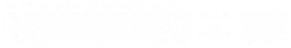

Hacking : Bloodwych Object Lookup Table
Objects in Bloodwych are represented by the following codes, in bother the Character Inventory and in the Object Data Blocks for each Dungeon:
01   Coinage
02   Common Keys
03   Arrows
04   Elf Arrows
05   1/3 Apple
06   2/3 Apple
07   Apple
08   1/3 Biscuit
09   2/3 Biscuit
0A   Biscuit
0B   1/3 Chicken
0C   2/3 Chicken
0D   Chicken
0E   1/3 Mead
0F   2/3 Mead
10   Mead
11   1/3 Water
12   2/3 Water
13   Water
14   N'egg (Green)
15   N'egg (Blue)
16   N'egg (Red)
17   Serpent Slime
18   Brimstone Broth
19   Dragon Ale
1A   Moon Elixir
1B   Leather Armour
1C   Chain Mail
1D   Plate Mail
1E   Mithril Chain
1F   Mithril Plate
20   Adamant Chain
21   Adamant Plate
22   Crystal Chain
23   Crystal Plate
24   Leather Shield
25   Buckler
26   Rune Shield (Classic)
27   Large Shield
28   Moon Shield
29   Dragon Scale
2A   War Shield
2B   Chaos Gloves
2C   Battle Gloves
2D   Mithril Gloves
2E   Adamant Gloves
2F   Crystal Gloves
30   Dagger
31   Stealth Blade
32   Short Sword
33   Long Sword
34   Mithril Sword
35   Fleshbane
36   Demon Blade
37   Ace of Swords
38   Battle Axe
39   Mithril Axe
3A   Troll's Axe
3B   Brainbiter
3C   Deathbringer
3D   Staff
3E   Battle Staff
3F   Power Stadd
40   Blodwyn (RIP)
41   Murlock (RIP)
42   Eleanor (RIP)
43   Roseanne (RIP)
44   Astroth (RIP)
45   Zothen (RIP)
46   Baldrick (RIP)
47   Elfric (RIP)
48   Sir Edward (RIP)
49   Megrim (RIP)
4A   Sethra (RIP)
4B   Mr. Flay (RIP)
4C   Ulrich (RIP)
4D   Zastaph (RIP)
4E   Hengist (RIP)
4F   Thai-Chang (RIP)
50   Bronze Key
51   Iron Key
52   Serpent Key
53   Chaos Key
54   Dragon Key
55   Moon Key
56   Chromatic Key
57   Serpent Wand
58   Chaos Wand
59   Dragon Wand
5A   Moon Wand
5B   Heal Wand
5C   Long Bow
5D   Frost Bow
5E   Cross Bow
5F   permit
60   Serpent Crystal
61   Chaos Crystal
62   Dragon Crystal
63   Moon Crystal
64   Grey Gem
65   Bluish Gem
66   Brown Gem
67   Tan Gem
68   Grey Ring
69   Serpent Ring
6A   Chaos Ring
6B   Dragon Ring
6C   Moon Ring
6D   Book of Skulls

Hacking : Keyboard Controls
It is possible to modify some of the Keyboard functions of Bloodwych fairly easily.
Starting with the very basics, the following is the code for the player 1 and player 2 keyboard controls for movement;
5F 46 4E 4F 4D 4C      12 10 22 20 21 11
This can be found in BW at ($0656) [$02EC] - or can be searched for manually.
These hex numbers represent the keycodes for :
Help - Del - Cursor Right - Cursor Left - Cursor Down - Cursor Up - E - Q - D - A - S - W
and can be substituted for alternative keycodes if wanted, in order to change the in-game keys.
It is also possible to change the operation of the key-controls for the main menu, but this is discussed seperately in the Menu Layout section of this resource.
For reference, the Amiga keycodes are laid out as such;
