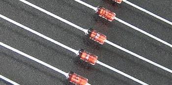

@FOL ,2 types Zener Diodes
like this one
keep memory,s as treasure
like this one
Yeh but, you said standard diodes. Zener Diodes are not standard diodes.
What about 1N4001, thats a standard diode, might be well over rated for what we need, but still.
Would really need to look at the circuit to see what it actually does and how it works in the circuit.
