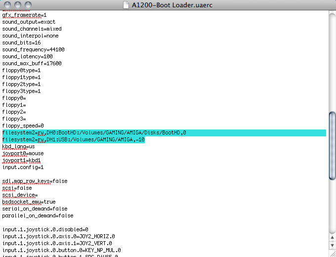

Initially, you create a single HD configuration for UAE (e.g. _BootMenu.uae)  which sets the BootHD as DH0: you then map DH1: to a position on your HD or USB stick (or other), which allows you access to your UAE Configs, some Template Configs, and a bunch of HD Games (usually WHDload installed games in my case, although they can be anything)
An example of my E-UAE config with two HD's mapped, DH0: as my BootHD and DH1: to my USB stick called "GAMING" in the "AMIGA/" folder

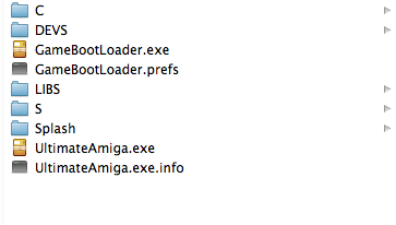

The contents of the BootHD folder which is mounted as DH0:

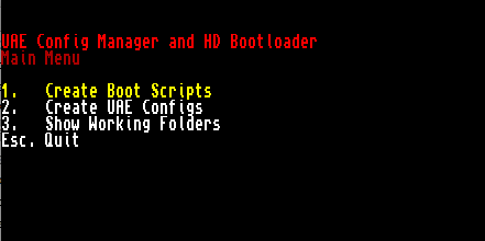

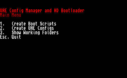

When the master config is booted with UAE, you will be presented with the keyboard-controlled menu system.
The program's Main Menu

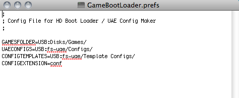

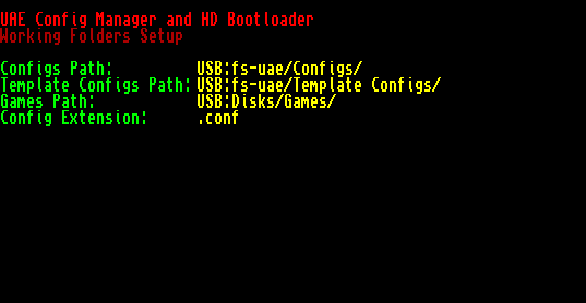

Inside the folder mapped as DH0: is an Amiga (or UTF-8) text file called "GameBootLoader.prefs"   - this mostly defines (from the Amiga's view) the location of the other folders, which I tend to have accessible from DH1:
- The master Games folder, where all of your sub-folders of games are kept.
- The configs folder, where it will save newly created UAE configs
- The Templates configs folder, where you store "pre-defined" templates for dfferent types of games **
- The extension to be used by the uae config.... eg. .uaerc for e-UAE, .conf for fs-uae etc.
** this might be templates such as, "cd32 pad mapping" "2 player mouse game" "standard joystick/mouse" "joystick-as-mouse map"  etc  ... you have to create these yourself!

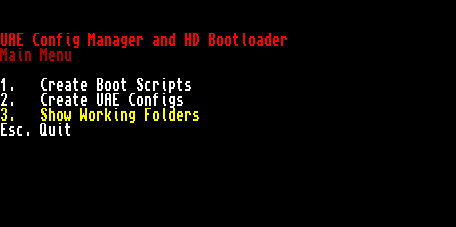

Selecting the Folder-Options from the Main Menu
The current program options from within the program
For example., my .prefs file reads as follows;
Code: [Select]
GAMESFOLDER=USB:Disks/Games/
UAECONFIGS=USB:fs-uae/Configs/
CONFIGTEMPLATES=USB:fs-uae/Template Configs/
CONFIGEXTENSION=conf
.... in this example USB: / DH1: is set to the AMIGA/ folder on my USB stick, and i am working with fs-uae config files.
The .prefs text file containing the options (viewed from the host machine)

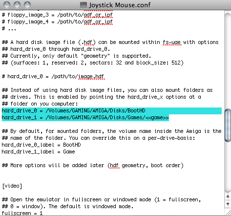

Setting up Template UAE Configs
Within my templates, you use a single substitution phrase " <<game>>  " in certain places.... this allows the program to 'insert' the name of a game into the config, and automatically set up the 2nd HD for that game to be booted from.
Here is another example from one of my templates where the HD's have been defined;
Code: [Select]
hard_drive_0 = /Volumes/GAMING/AMIGA/Disks/BootHD
hard_drive_1 = /Volumes/GAMING/AMIGA/Disks/Games/<<game>>
hard_drive_0_label = BootHD
hard_drive_1_label = Game
(I also use this to define the application "title" with:
Code: [Select]
title = <<game>>
sub_title = Autoboot Config
With Templates created, and the folders defined, this initial Batch Mode has all the info it needs.
An example Template UAE config (viewed from the host machine) for fs-uae

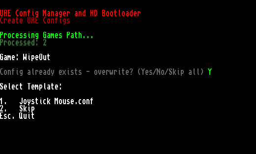

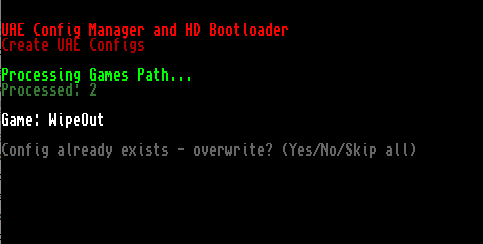

Creating UAE Config (Batch Mode only)
Selecting the UAE Config manager from the main menu.
Once run, it seeks through the Games folder, and using the folder name as the game name, checks to see if a UAE config folder exists for it.
E.g, if it finds the folder  "USB:Disks/Games/RainbowIslands/" , it will check for the existence of the files "USB:fs-uae/Configs/RainbowIslands.conf" .... if this does *not* exist, then the program will ask if you wish to create it, and then which template you wish to use for it. It performs the "<<game>>" substitution, and saves the .conf file.
This is then repeated until either you quit, or the end of the Games/ folder is reached!!
The existence of a previous config is found, and confirmation to continue requested.
Listing the available UAE config(s) to selec from.
Selecting a Template Config for the game to use, and UAE Config creation.

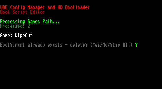

The BootScript Editor is also available in Batch Mode, working in similar fashion to the UAE Config creator.
Selecting a the BootScript Editor in the main menu of Batch Mode.

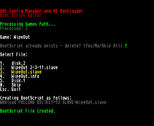

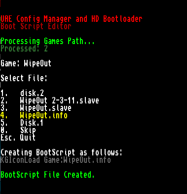

When you ahve loaded the BootScript Editor, you are presented with a list of available files.
Viewing a Game's folder from the BootScript Editor, and creating a BootScript from a .info file.
You are offered the chance to select one of the files in the Game's directory, and this file is used as the 'parameter' in the BootScript which is created.
In most cases, if you select a file, it will create a script which reads:
Code: [Select]
EXECUTE FILENAME
However, if you select a .slave file for WHDLoad, it will use a set of pre-defined options and create a script such as:
Code: [Select]
WHDload PRELOAD QUITKEY=93 SLAVE=filename.slave
and lastly, (and i think, i most usefully) , if you select a .info file it will use KGIconLoad, to run the .info files pre-set tooltypes. This means, that if you are sharing your GAMES: folders with a setup which uses WorkBench, you will be able to share your ToolTypes set on any icon between the "single game" setup, and your WorkBench setup. This is particularly useful is used in conjuntion with WHDload, where tooltypes are often used to allow extra game-options, such as ButtonWaits, or Trainers.
Once a script has been created, the system will reset, and the BootScript will be run.
If a BootScript already exists, you are offer the chance to keep the existing file.
Creating a BootScript from a WHDLoad .slave file, with pre-set options

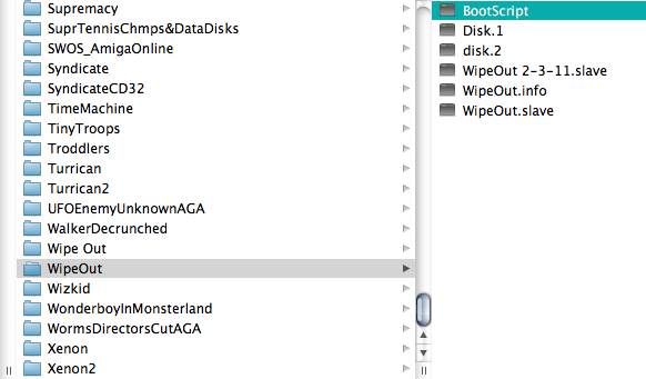

The BootScript created in the Game's folder (from the Host machine)
The BootScript file viewed in a text editor (shown from the Host machine)
