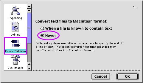

I strongly recommend using StuffIt Expander to unzip the archive. I have nothing against ZipIt just I don't know how to do this in ZipIt, so it's best to be safe and use StuffIt. You'll also need DropStuff with Expander Enhancer. OK, you're ready to begin. Launch StuffIt Expander (do NOT unzip the archive yet). Select File->Preferences...; it will bring up a dialog similar to the one to the left. As shown, select the "Cross Platform" option in the left column. This will give you the option of (as shown) whether or not to translate files into Macintosh format. Select "Never". This will prevent StuffIt from, in short, screwing up AIAB. Click "OK" to exit the dialog. |

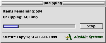

Now just drop aiab-2000.zip onto StuffIt's icon (you know how to do that, right?? :P). It should bring up a dialog similar to the one to the left and unzip the archive. Just wait until the dialog disappears, then this step is done! AIAB is unzipped, PROPERLY... YAY!!! |

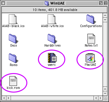

OK, now open (inside the Workbench folder): "Prefs:Presets:env-archive". With the "env-archive" window active, type "sys". The Finder should highlight the "sys" folder. Drag the "gui.prefs" folder into the "sys" folder and replace existing items. Got it? 'k! :) Now, drag the "uaerc" file into the "WinUAE" folder. Also put the MacUAE program here, as well as your kick.rom file VERSION 3.1, as shown in the image to the left. Sorry there is no kick-searcher for Mac.. if you know how to, and want to code one, please do!! |
